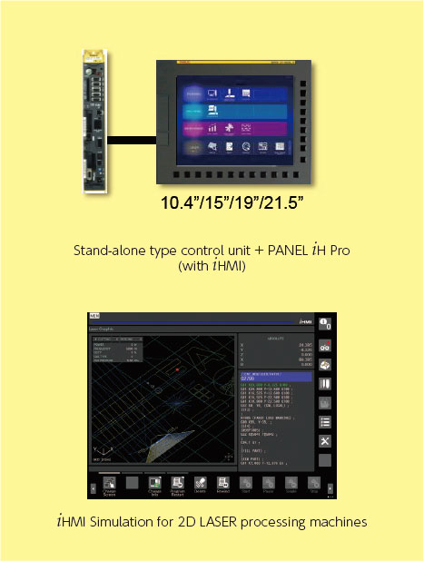

Optimal specifications for 2D LASER cutting machines
This model has up to 7 control axes, 1 path, and 1 oscillator; the optimal specifications for 2D LASER cutting machines.
A variety of control functions come as standard to achieve high cost effectiveness, such as the Gap Control Function for sheet metal LASER cutting and functions for setting LASER Cutting parameters, which can easily be executed through program commands.
Customization functions are standard
Customization functions, such as FANUC PICTURE, C Language Executor, and Macro Executor, are included as standard features to enable screens suitable for LASER cutting machines to be created more flexibly.
iHMI Simulation for 2D LASER cutting machines
This model is dedicated to 2D LASER processing and can graphically display the machining path and piercing position of the program selected beforehand. During the process, the progress and conditions of cutting, rapid traverse, and beam ON/OFF can be confirmed with multiple types of line drawings.
