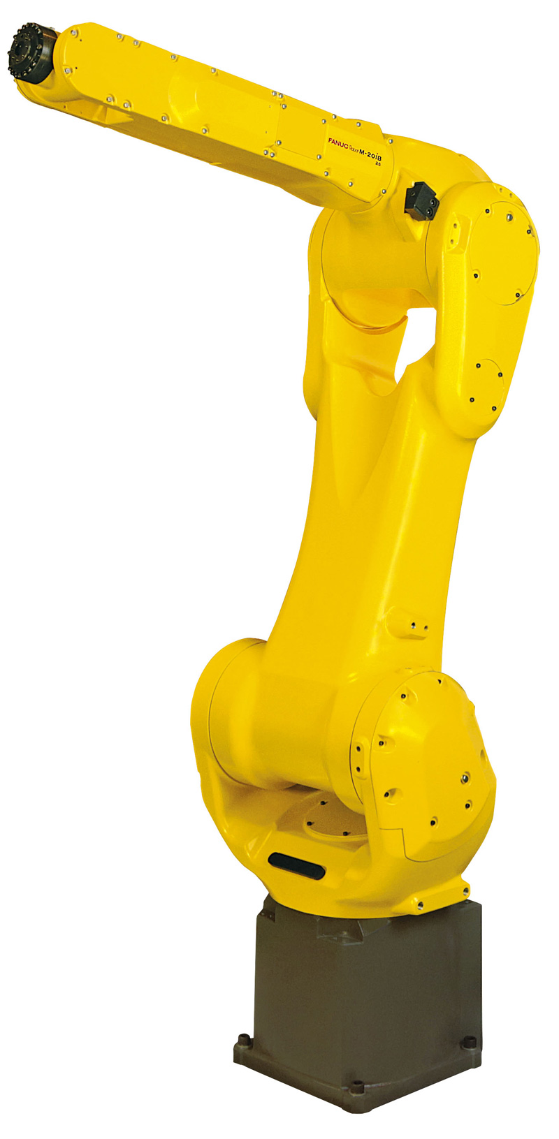

FANUC Robot M-20iD
FANUC Robot M-20iD specification
![FANUC Robot ARC Mate 120iD, FANUC Robot M-20iD](../../../../ja/product/robot/image/arcmate120id.jpg)
![](../../../../ja/product/robot/image/arcmate120id_xy.gif)
![](../../image/img-product02.png)
Brochure (English | Chinese) |
FANUC Robot M-20iD |
/25 |
/35 |
/12L |
Controlled axes |
6 |
Max. payload at wrist |
25kg |
35kg |
12kg |
Motion range (X, Y) |
1831mm, 3461mm |
2272mm, 4343mm |
Repeatability |
±0.02mm |
±0.03mm |
Mass (without stand) |
250kg |
Installation |
Floor, Upside-down, Angle |
Matching controller |
R-30iB Plus (A-, B-cabinet), R-30iB Mate Plus (standard) |
Application |
Handling |
x |
Assembling |
x |
Arc welding |
x |
Sealing |
x |
Others |
Mold handling, Deburring |

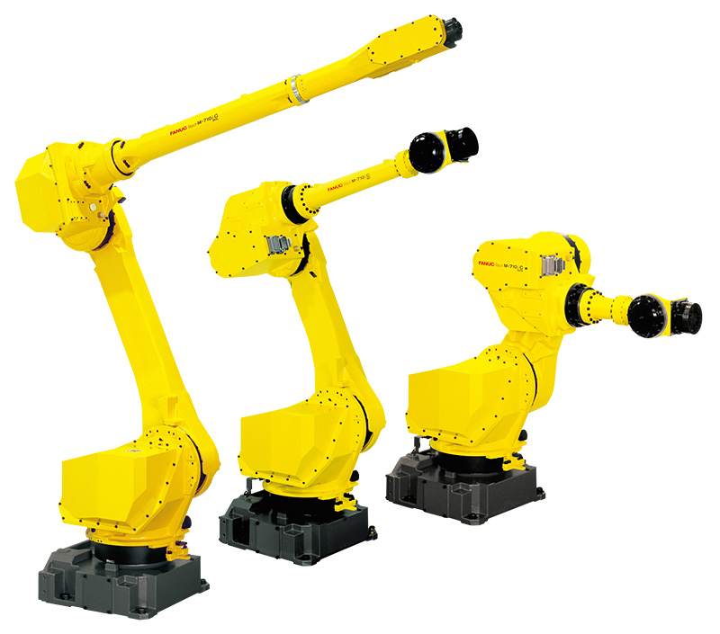

FANUC Robot M-710iD
FANUC Robot M-710iD specification
![FANUC Robot M-710iD](../../../../ja/product/robot/image/m710id.jpg)
![](../image/m710ic_xy.gif)
FANUC Robot M-710iD |
/50M |
/70 |
Controlled axes |
6 |
50kg |
70kg |
2606 mm, 4758 mm |
2104mm, 3788mm |
Repeatability |
±0.06mm |
±0.03mm |
Mass |
600kg |
580kg |
Installation |
Application |
Handling |
x |
x |
Assembling |
x |
x |
Arc welding |
x |
x |
Sealing |
x |
x |
Spot welding |
x |
x |
Others |
Deburring, Laser cutting |
