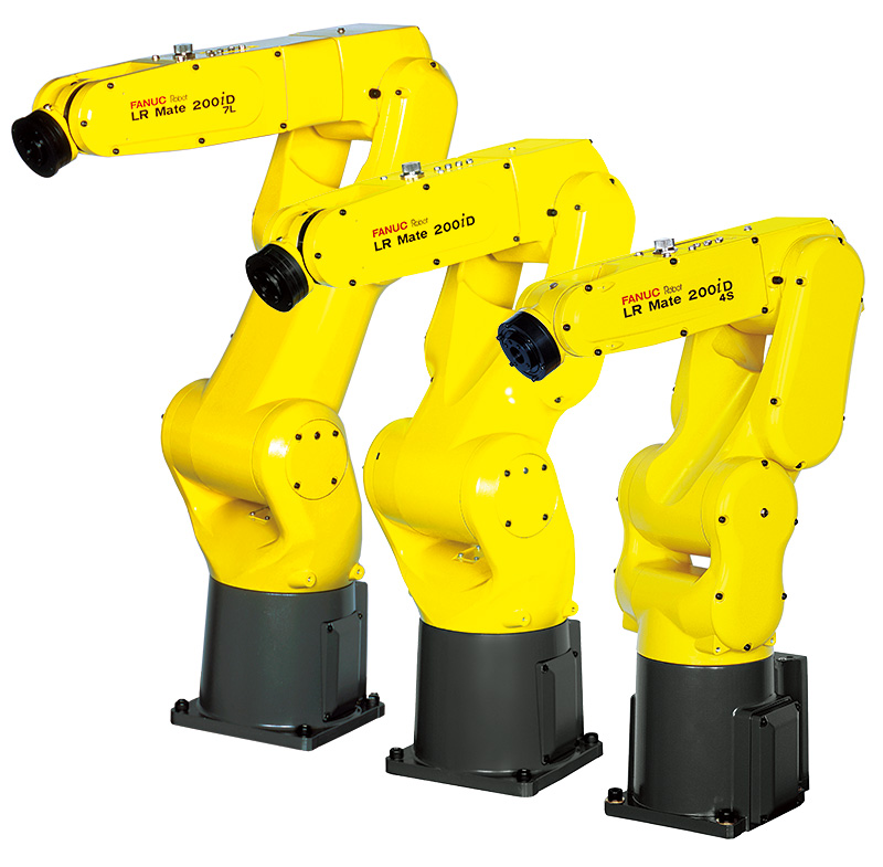

FANUC Robot LR Mate 200iD / ER-4iA
![FANUC Robot LR Mate 200iD, FANUC Robot ARC Mate 50iD](../image/lrmate200id.jpg)
